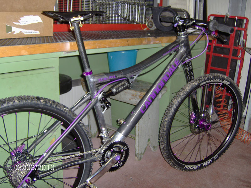

Component Description (Manifacturer Model Size Notes) Weight (g)
Bar Ends: ///// 0
Bottle Cage: ///// 0
Bottle Cage Bolts: purple titanium 2 x M5x15 3
Bottom Bracket: Leonardi Racing 122,5 spindle + Cannondale BB30 bearings 156
Brake Levers: Formula R1
Brakes Rear: Formula R1 + Ti bolts + XX 140 rotor + X-tra-R adapter 281
Brakes Front: Formula R1 + Ti bolts + XX 160 rotor + X-tra-R adapter 278
Cables / Housing: Alligator purple + Sram X.0 75
Cassette: Recon Ti 11-32 180
Chain: Sram Pg-1090R 10V 241
Crankset: Cannondale SL polished spacers and shims 18
- Crank Arms: Cannondale SL polished 263
- Crank Bolts: Cannondale purple 20
- Outer Ring: ///// 0
- Middle Ring: Leonardi Racing - FRM 40 80
- Inner Ring: Leonardi Racing - FRM 27 43
- Ring Bolts: Extralite purple 7
Derailleur Front: Sram Red + BTP clamp 77
Derailleur Rear: XTR Shadow RD-M972 GS tuned 177
Fork: Lefty OPI 2009 + carbon tube by Matthias 1203
Frame: Cannondale Scalpel carbon polished 1693
Grips: Progrip 18
Handle Bar: Mortop carbon 25,4 87
Headset: Cannondale 52
Headset Cap/Bolt: ///// 0
Headset Spacers: ///// 0
Pedals: Egg Beater 4 TI 168
Quick Releases: Extralite Alien purple rear 30
Rear Shock: DT Swiss XR carbon + purple Ti bolts 168
Seat: Nobrand carbon 98
Seat Binder: Extralite purple 11
Seat Post: XX SP27 90
Shifters: Sram Plasma 3 x 9 119
Stem: Extralite UL3 80
Tire Front: Schwalbe Rocket Ron Evo 2,1 422
Tire Rear: Schwalbe Rocket Ron P 2,1 476
Tubes: Sealant 161
Wheel set (Front): valve + yellow tape 20
Wheel set (Rear): valve + yellow tape 20
Wheel Set (Entire):
- Rims: NoTubes ZTR MMX Podium 570
- Spokes: DT Swiss Aerolite 285
- Nipples: Alu purple 25
- Hub Front: Tune Cannonball 93
- Hub Rear: Tune Kong 210
Misc Option:
Grease and Lubricants 52
Total Weight 8050 Grams 17,75 Pounds
